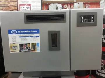

I saw this wall mounted pellet stove at Tractor Supply
