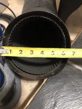

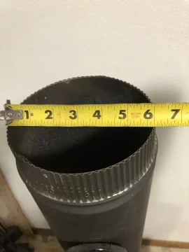

I went and bought some 6 pipe and it doesn't match up. I thought okay, must be 7". Couldn't find any, but found a 6 to 7 converter. That doesn't work. So I figure I better take exact measurements. (You'd think I'd do this from step one). Anyway --- 5.5 inside and 6.5 outside. The "female" is 6". I took it with me to local stores and no one could help me. I called a wood burner store, and they wanted to see it. They are an hour away. So I figured I'd check here before making that journey.
Does anyone know what this is called and if so, where I can get it?

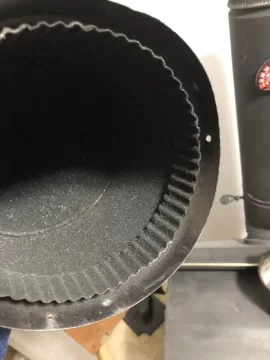

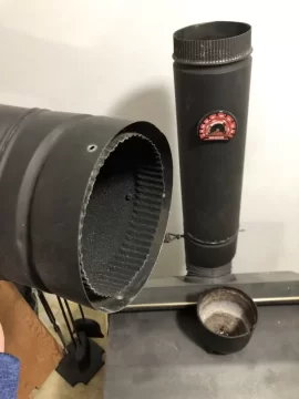

It looks like you have double wall stove connector pipe. It has an inner 6" pipe with a jacket that provides a 1/2" air gap. This is common but I'm not sure the brand. It may be DuraVent DVL. Can you post a picture of the other end and a side view of that end?
Looks like 6" Selkirk DSP. Left pic is the end that attaches to the stove collar. Right pic is the end that slides up over the connector pipe to chimney pipe adaptor. The ribs on this upper end are covered by a band to cover the crimped end for asthetics/looks. At least that's what it looks like to me.

The pipe may be Selkirk DSP. @Jerid it would help to see the other end to be sure.
Yes, that looks like 6" Selkirk DSP as moresnow suggested. Northline Express and Lowes sells it.
