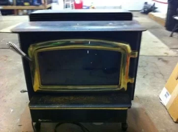

Found this stove on my local CL. Anybody know what this thing is, is it worth $250? Looking to heat my 900 sq ft cottage with a freestanding unit, or maybe my insulated pole barn?? Sure would be nice to ditch LP at the cottage.

Looks like an earlier version of the Regency F2400m. I think it was called an F2100...Good stove, if there's no warping of the plate steel, or cracks near the corners behind the door. Rated at 75K BTU. The blowers don't mount under the ashlip like that on the current models...
