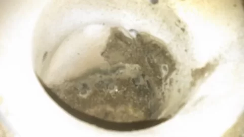

I have a Quad Santa Fe and am enjoying it. Just curious as to what the pastey substance is that forms in the burn pot. Is it the beginning of a clinker? I am familiar with what a clinker is as I burn real charcoal in my grill and get them frequently with that.

Yes OAK installed. Will take pic at next clean out in a few hours... FWIW I am burning NEWPs now. Got them with the stove.

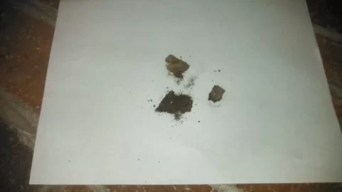

Here are some pics. After it cools it crumbles but when warm it is like paste.
Hope the pics come out...

I would blame New England Crapwood
