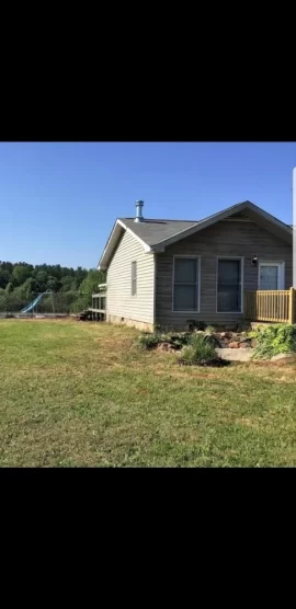

We are considering purchasing this home and the owner said the heater can stay or go....just curious to what it is... sorry for the bad pic. That's all I got.

I am biased towards soapstone and now more recently catalytic so I'm the wrong person to ask. Personally in that set up I'd come out the back of the stove, if possible, then do a 90 then go straight up aesthetically and easier to clean with a T at the 90. Some stoves allow either a back exit or a top exit.

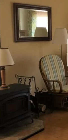

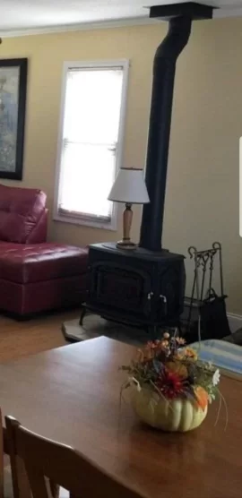

Here are a couple more pictures. Sorry for another bad one of the heater but maybe it'll help. I need to get my butt over there and take some of my own. I pulled these from the real estate site.

It doesnt look like the hearth is big enough. Otherwise it looks ok. But all clearances should be checked
It looks like a Quadra-fire. Not sure of the model. Absolutely keep it!
I'm pretty sure it's a Quadrafire Yosemite. This model is discontinued which should provide a bit more negotiating room. Maybe offer $800 if it's in great shape?
That’s a pretty crazy suggestion... top exit makes for a superior setup. Avoiding a 90 or a Tee is always better if possible.

Yep- its a Yosemite. Nice mid-size side loading stove. Good for about 1500sqft here, 6-8 hour burn. I remember their handles being a bit of a pain, but was a nice looking stove..
The hearth does not look compliant as someone said earlier.
I'm wondering if the stove could be moved back closer to the wall so that it meets the front 16" requirement. The Yosemite needs 7" with double-wall stove pipe. That looks like a Yoder hearth pad which is not cheap. It would be great to still be able to use it, but that's hard to say. This is also a side-loader so in order to use the side door there needs to be 16" hearth protection on the right side too.
If the hearth pad is undersized no matter what, then sell it. The Yosemite only requires ember protection so that is relatively easy to satisfy.
