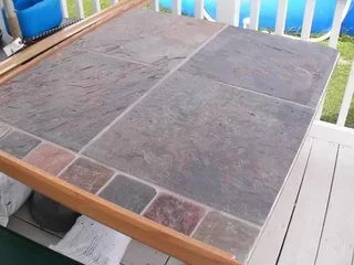

I made my own this summer 36" x 32". Cost me around $60.00. You will need:
36" x 32" piece of plywood
same size piece of cement board (bought the whole sheet $9.98ish)
4-16"x16" tiles
8-4"x4" tiles
pre mixed grout (small container)
and I used 3 long pieces of hardwood flooring for the edge.
Screw the cement board to the plywood, grout the cement board, stick the tiles to it, fill in the spaces with grout. Let dry.
Got it all at HD. Looks great!

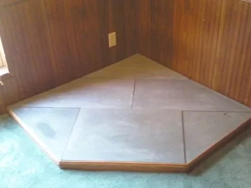

Here's a pic of my corner hearth. It's 1" thick bluestone. I haven't done the grout yet. My stove manufacturer required 6" in front of the door and 3" off the back corners so I measured it out accordingly to give me plenty of room.

Nice!!! Doesn't it make you feel good to do-it-yourself instead of paying $200-$400 dollars for one?

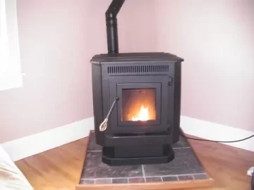

My set up.
It feels good to be done with it! I paid a little under 200 for materials 135 of that was the rock. They can be done much cheaper. I wish now that I would have used a multi colored (and cheaper) rock because the bluestone is more bland looking than I thought it was gonna be. Tough luck. It's gonna have to grow on me!
I love the way it goes into the corner of the room. I'm a girl and couldn't quite figure out the dimensions and had no way to cut the tile.
Just draw it out on paper the design you want. Then you find out your stove's clearances which is usually in the owners manual or brochure. I made a template out of 1/4" plywood to chicken scratch my measurements in pencil and draw a box where the stove is gonna sit. If I learned one thing from this project it's measure TWICE cut once! Mine ended up being not perfectly symmetrical by like 1/8" which makes it difficult when you're having a guy cut 1" thick stone for you and he has one shot. I made up for it by adjusting the grout lines but the bigger the rock the harder it's gonna get.
