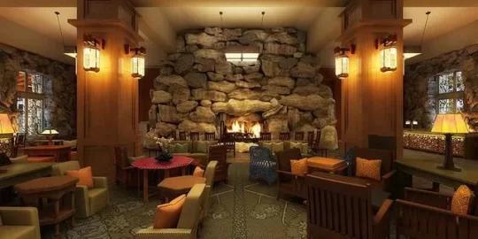

The Grove Park Inn in Asheville NC has two huge fireplaces in the lobby. They are about 10 feet wide. The huge stone lintels weigh tons.
They burn sticks about 5 to 6 feet long, that really looks cool to see those big logs burning in the huge fireplace.

Grove Park Inn, Asheville NC. The fireplace is so huge that it dwarfs the huge opening which is at least 10 feet wide.
If you are ever in Asheville, go to the Grove Park Inn, it is worth the visit just to sip on some Jack Daniels and watch that enormous fireplace in action.
