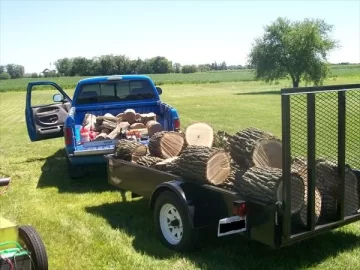

I have a 5x8 dump with a 5K axle that I stack 4' high on. Works very well given that I load by hand and also is great for mulch. I also have a 6x12 tandem axle dump but loading the front 4' is clumsy and time-consuming. While a blowout with a single axle trailer is inconvenient at best, it is much easier to maneuver in tight places. Ideally, I'd have a 7x8 with a single 10K axle on it. Whatever you end up with, spend the money on a brake controller as it will pay for itself many times over. Brake jobs on 3/4 ton trucks are expensive.

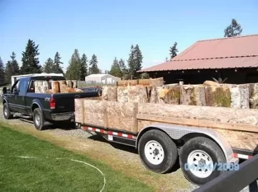

Similar to highbeam above I own a 20' car hauler (bought it from Kaufman trailers online). It's 2300lbs dry and has 8,000lbs GVWR. Not including the dovetail I have 17.5x7 with 2' side rails. Loaded to the gills I can haul just under two cord. This puts me a tad bit over the 8,000lbs rating of the trailer but I think she's done fine. Brakes on both axles are a must...save the truck.....
I also agree 100% with Highbeams statement about "a full days work". Rarely do I unload my trailer the same day I drop, buck and load it. That's a lot of wood...and this guy drinks beer immediately following the cutting part.....maybe even some during if the mood hits me....

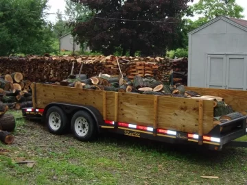

I also use a car hauler, I bought it for my car but serves a dual purpose for the wood. It has a GVWR of 8500, brakes on all four axles and does the job just fine. It's 18' with a dove tail, my sides are 16'x7'x2' so if I fully load it I can haul almost 2 cords if I was to stack nicely. When I'm cutting though I'm usually pretty burned out when I get about a cord done.
