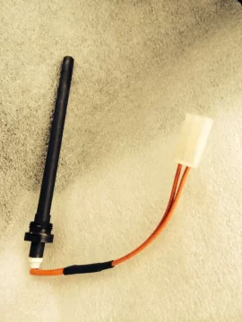

Just got this igniter?
Does anyone know what stove it goes in?
The molex connector has 2 male round pins. It is 310 watts 115 vac.
It is about 6" long with a screw in collar. The wire colors are red even though the picture looks orange!

I can tell you it is not a Breckwell, Vogelzang or any USSC.
Hello, it looks similar to St.Croix ignitors, but don't think the connectors are the same...
Yes but St. Croix does not screw in.
Not a Breckwell Hot Rod ignitor or Vogelzang, it looks like an Ardisam that how I figured it out, that is my hint, but really is a USSC!
Which Model?
The only USSC that had that screw in on the ignitor is a 5824, but the wire colors are wrong. Bosca had that type a lot.
The igniters are AC what difference does the wire color make?
Is this it? The wire colors are red here too.
(broken link removed to http://www.stove-parts-unlimited.com/USSC-Stove-Igniter-p/80564.htm)
No the colors don't make a difference. They look orange. Red would be correct. 80564 is the right part number for a 5824. :oops:
