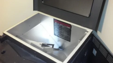

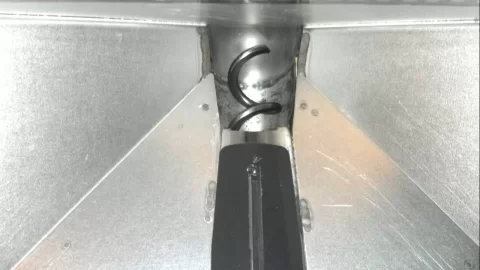

Whats the design on that and how does it work??
Its a Spring. Literally.
The motor is at the top (under the square cover) unlike most stoves (top feed) that have the motor on the bottom of the flight and push the pellets up (and fines drop down through bushing)
This has a sealed bottom and auger pulls the pellets up to the drop chute. No contact with flame, no need to scrape carbon (there is none)
The drawback to this flexible system is that fines are left at the bottom and will eventually slow pellet feed and in extreme cases, stop pellet feed.
