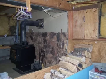

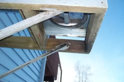

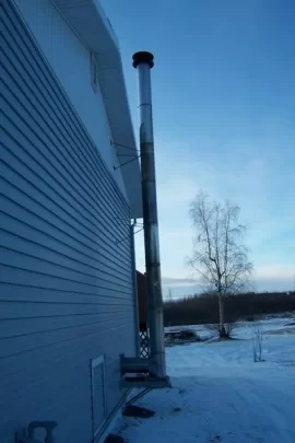

What is you stack length & set up?
mine has 2 90° to go thru & from stove to cap is over 20'.
I want to do 2 45°s above the stove this summer & see if it helps
pull the clean out plug & brush
Straight up is recommended the best (but I got to go this way)

Thanks BDave. I had to move the stove forward for clearance, so 2- 45's were added to create a 6" offset( both verticle). The existing flue stayed the same. I could probably use another 2-3 ft. on the exterior, couldn't hurt.

Mine don't like the 1.75 setting either. I thought it might be the inside 90°, & long stack, exhaust cools off before it gets to the top, colder air heavier & pushes downward air pressure.
I want to change this summer & have 2 45s, but you do & it didn't seem to help.
I'm convinced it's my 20' stack , but haven't got a solution yet.
With the cat, I can almost hold my hand on the single wall pipe above the stove. Hard to get the warm air to travel up 20' if outside air is cold.
Maybe pull the clean out plug, (i've thought that but for some reason haven't done it yet)
I have yet to successfully burn in the smolder mode, much below 2. I get good burn times but warmer days I overheat the house (learned to build small fires on days warmer than 30f)
Hoping it's a learning curve, I've tried several things so far, 2 45s this summer.

Beetle, that may be marginal at my altitude, but up above 8000' I think it is insufficient. Any further restriction in your flue from creosote buildup will make an insufficient flue nearly useless. Once those flue temps drop, no amount of opening the intake air is going to give you high enough flue temps to get that draft back in the range it belongs. It may have worked OK with the old stove, but with the low flue temps found in cat stoves, you really need a good chimney way up high where you live.
BTW, I didn't see where you mentioned it... you are running 8" pipe, correct?
