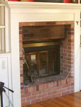

Does it look anything like this? If so, we're in the same boat & I can give you a few more pieces of information.
  • [Hearth.com] what to do with a double sided or see-through fireplace
