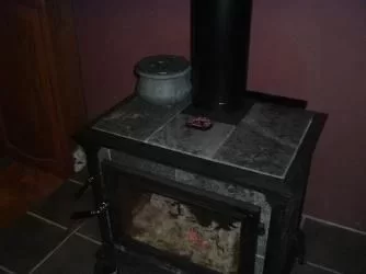

I want to set a pot of water on my new Hearthstone soapstone Heritage but have been told that a pot will scratch the soapstone. What do you all use between your soapstone and your pot?

Ack... I put nothing at all in there. It is hard enough to boil off water with the cold running soapstone stoves so why make it worse with some sort of insulator?
The trick is to leave the pot on the stove and refill it with a kettle. If you never move the pot then it can't scratch anything. Also, be sure that you don't trap any grit between the stove and the pot.

I put my pot right on top and I haven't seen any scratches.

I have a Revereware kettle which isn't too heavy and just carefully place it on the stone without sliding. Use a sheet metal kettle or pot, not cast iron to reduce weight and scratching possibility.
I used a short length of rope gasket too. I got a length of it for less than a buck and used a tiny amount of stove cement to attach it to the bottom of the enamel pot.
