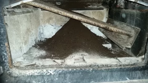

Cleaned my chimney with a Sooteater today, as I've done for the past 3 years.
It did a great job. I probably got 2 quarts of powdered creosote from our stainless liner.
NOTE that I also use Rutland creosote remover, which seems to do a good job of turning sticky creosote into an easily removed brittle powder.
You should have no need for creosote remover with that quad if you are running it right. It shouldnt hurt anything but you are probably wasting your money
Cheap insurance.
