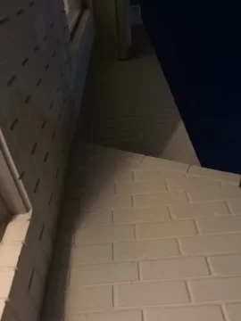

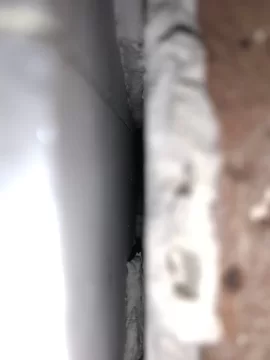

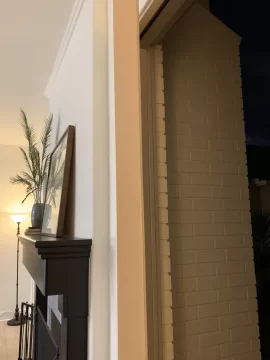

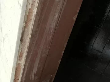

For clarification, when you ask about "it" do you mean the 2nd floor (fireplace is 1st floor) interior wall, or do you mean the backing for the marble tile? The marble tile is directly on the brick. It appears that the interior walls of the house on both the 1st and 2nd floor are drywall, but it's very possible that there's a non-combustible layer behind there, as the fireplace wall juts into the room (and the chimney is outside the wall of the house). In fact, you can see in the pictures here that there is a 2.5" extension of the fireplace-portion of the wall into the room. It's all brick behind the chimney part...we tried to hang a picture to no avail. Not sure if this offers any clarity or not.
A builder working on our house said, "You have a double brick chimney," for whatever that's worth.
You're right about the measurement, it's probably more like 1/2" thick between the marble tile and the brick....and it may be irrelevant to my smell issue.
Photos attached (including one taken out the door that shows both the lower chimney and interior fireplace in the same picture) (and another photo of the gap between the marble tile and the brick).

Ok those pics are better. Fill that gap with mortar of some sort . But the smell in an upstairs cabinet is concerning
