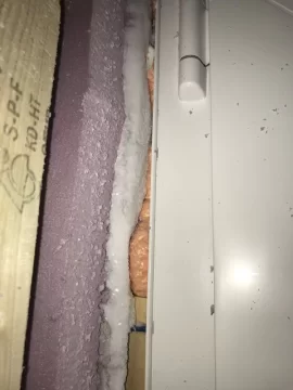

I've been working on tightening up my basement. Found some ice growing on the exposed concrete around some windows.

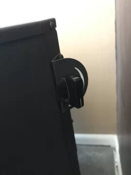

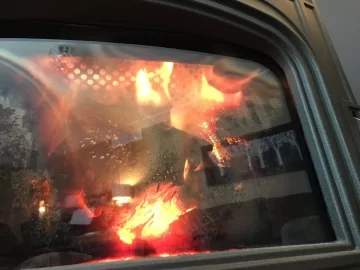

Here she is rocking away on high. I'll snap a picture of chimney cap in an hour or so.
