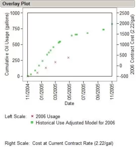

I can help you there - NY State Energy Research and Development Authority posts data for Albany and other cities throughout NY. Easy to read format too:
http://www.nyserda.org/Energy_Information/nyepk.asp
I have been accumulating data this year and am comparing to three years prior data when we had oil heat only. We still have the thermostat kick in at the same temperature as before, but we usually run 3-4 degrees warmer throughout the house when running the stove - this benefit is not accounted for in the results.
Based on the heating degree day information through the end of February at my last update, I had to deduct 14% of our historical numbers to make it a fair comparison. I concluded we had saved 254 gallons of oil as of the end of February, and we are generally more comfortable due to the house being in the low 70s instead of 66-68.
The attached plot shows a model I created in JMP to reflect the three prior years' average use corrected for the heating degree day differences in 2006 plotted in red, and this current year's usage is plotted in green. Note this also includes all domestic hot water use.

Got a new oil delivery today and updated my analysis as shown in plot attached. Mean historical data pre-wood-stove is plotted in green based on a simple polynomial fit with corrections applied for heating degree day differences in 2006. Use after wood stove is plotted in red. (disregard year value in x-axis) Cost of the oil at our current contract price is shown on opposite Y-axis.
Summary for year to date is 320 gallon reduction in oil use, saving $710 in cash outlay while also achieving moderate improvement in comfort levels.
That probably works out to about $5/hr savings for my woodsplitting and hauling efforts after factoring in some depreciation for the stove/chimney... that's about minimum wage after taxes! Not so bad compared to a gym membership at least :-)
Misc. notes and assumptions:
I have been accumulating data this year with the woodstove and am comparing to three years prior data when we had oil heat only.
We still have the thermostat kick in at the same temperature as before, but we usually run 3-4 degrees warmer throughout the house when running the stove - this comfort benefit is not accounted for in the results. We also keep the house warm all day due to continuous burning as opposed to cycling down the thermostat during workdays. Some loss of efficiency in that regard.
Results are corrected for heating degree days through end of March. (will update further when April data is released) Heating degree days for 2006 were 12% less than the average of the previous 3 years when I collected my pre-wood-stove oil use data. The historical use model has thus been adjusted downward to what we would have projected our use to be in 2006 with the warmer winter we have had.
Overall I am very satisfied with the results - they are not out of line with efficiently burning ~2.5 cords of wood this year. A simple paper calculation assuming equilibrium in the house (we have good heat distribution) would suggest that we should displace ~400 gallons of oil assuming you maintain identical temperatures. Since we are keeping the house a bit warmer all winter, I am not surprised that we see a little less displacement in oil use than the simple calculation. We are certainly a lot more comfortable!
Will continue this process over the next couple of years as we keep burning - with oil up to $2.70/gallon it's only going to look better for wood.
