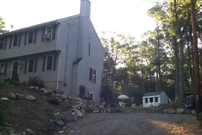

My house came with a heatilator fireplace...the kind that doesn't throw any heat. I'm told that this only has a b-vent pipe for a chimney, and to get a "real" fireplace/insert/stove...(the kind that does throw heat!), it would have to be replaced with a class-a chimney....
so what do you think it would cost me to do that? I know that stove/insert prices vary...so how 'bout "just the chimney" part?
don't know exactly how high it is, but since the house has 8' ceilings, ya gotta figure its 25-30 feet up there. and I ain't gettin' up there to do it. :cheese:

But the builder did some "armchair architecture", and the fireplace is in the "wrong" place in the room. totally screws up the hope of any comfortable furniture arrangement in the living room (the front-corner room in the pic). the center of the house is held up by a beam, so its all "open"...that room only has 3 walls...one of them taken up by the fireplace...not enough room on either side of it for anything. so that leaves 2 walls...anyway, I'm planning for a pellet stove, which will go unobtrusively in the front corner, and vent out the side.

nah, my house isn't that big. It just looks it from that angle...walk-out basement on that side, and it sits up on a hill. Its just a little 24'x36' garrison.

well, look at the house. its a 2 story shoe-box. I don't see any way of getting out of putting 25' of chimney "somewhere". Seems to me that it would be most practical to put it in the "chute" that already exists. But if you have to dismantle the existing chase in order to properly install a chimney, maybe it doesn't make any difference. (how else would you get in there to do it?) I guess with vinyl siding, you can remove that without damaging it...cut out the plywood...do what you gotta do...replace/patch/whatever with new sheathing, and cover it all over with the existing vinyl, and nobody would ever be able to tell it happened. would that be the likely process?
I am going at mine from the inside (cutting an access panel in the chase through the drywall in a closet) - but mine is an interior chase. I don't think you would necessarily have to (or want to) take off the siding, but every case can be a little different.
Actually they did my Chase at 35' Yesterday. They took Ladder and went to top of Chase False one like yours. Took the top off and ran pipe through the wall and into the chase insulated the way up to cap. Cut through 2 layers at the top then the metal chase cap sealed it up, and have three feet above the now insulated chase. It wasn't cheap like 800.00 labor for 2 guys who new what they were doing but a very clean install.
