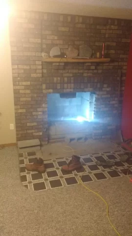

So yesterday I ripped out an old slammer insert in a house I have lived in about a year. Now we have a huge hole in the wall.
Some details:
-exterior chimney
-This is in a walkout basement with one level above (2500 sq feet total in Northern MN brrrr)
-rough opening about 3 feet wide by 4 feet deep and 4 feet high
-a clay lined chimney starts around 6 feet high which has a big metal tube sticking out of it now for old insert connection
-I plan on doing masonry work to re-build the hearth and put on new veneer with whatever is chosen
-hearthpad where black linoleum sits is large so no worries about clearances or awkward walkways
My wife and I both love the Jotul F55 but are unsure about how to incorporate it, do we close off the wall with bricks and do a thimble of some sort? Build a hearth to accommodate a partial hearth-mount? I have read just about everything I can but can't seem to figure out how the chimney would work in this scenario.
