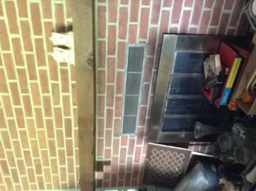

Hi everyone, I have been lurking and searching these forums for about a month now. Hubby and I will be moving into an old farmhouse in the next month. An addition was put onto the house in the early 1970s. The addition is a living room with a fireplace and master bedroom above. Hubby grew up with a wood stove his parents still use. It's a basic black steel box with no name visible on it from 1980ish. We would like to heat the farmhouse exclusively with wood and use the existing chimney. Im going to try to upload two pictures I took when looking at the house. From my understanding, a freestanding wood stove is our best option for heating the entire house, cooktop, etc. however, I'm concerned how much we will have to build out the already raised hearth to sit the stove. From my understanding, we will also need a rear flue. The only stove we have found local so far that might work is the Jotel Oslo 500. I was hoping for something cheaper but I don't want to regret a cheap purchase. So, I'm going to the house Sat. What measurements do I need in helping make a decision? What things can you suggest based on the pictures of the opening and the outside chimney? Anything to help my research would be appreciated. this is a big investment for us but one i know will be worth it.Thank you so much!

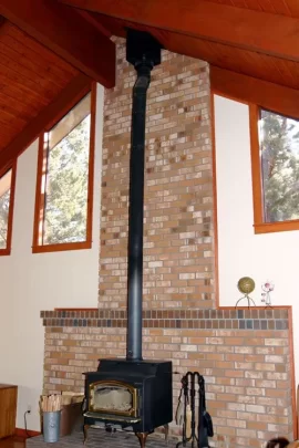

The setup you're describing is commonly called a hearth-mounted stove. Yes, you will need a rear-vent stove, unless your fireplace has a very high lintel, which is the key measurement for a hearth mount. You could use a top-vent stove, but you'd have to punch a hole into the chimney above the mantel. Here are pics to give you some ideas:
(broken link removed to http://www.woodstove.com/owner-photos/stove/4)
A rear-vented install gives a cleaner look, IMO, but only a handful of stoves on the market are rear-vented, and none of them are inexpensive. The usual suspects are Jøtul, Morsø, Quadrafire(a few), Hearthstone, Woodstock. A Woodstock opens only on the side, so it would require less hearth in front (8" vs. 16" for a stove with the door in front.) The Oslo is a very popular stove. Dunno if its flue will fit below your lintel, or if you need a bigger stove to heat your farmhouse. . .more details required: size/layout of house, insulation, climate, etc. Welcome to the Hearth. :)

Before you get too far, you need to get some measurements of the fireplace opening, as well as the depth. That will be the deciding factor as to what you can do.
From the vents above it, it looks like it is a prefab fireplace. That also could be an issue. Not all of them will accept an insert, and they usually aren't very big.

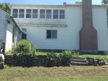

Which hearth stove did you choose? The chimney is on the outside wall as pictured above so I'm afraid we would lose a lot of heat. I also wondered about cleaning. We prefer simple too.
Finding a stove that can be installed as a hearth stove in your situation, and meets all your expectations, I think is gonna be tough. Another option not discussed is to decommission the old fireplace and the old chimney, partially rip out the old appliance, brick up the fireplace opening, extend the hearth and install a freestanding stove with a straight up flue all its own. Just some more food for thought. Rick
[Hearth.com] What would you do?
Thanks for the picture Rick! I actually was just checking out the Englander mentioned above and it seems to be more of what we originally had in mind. However, how could we make it work? How complicated would it be to put the hole in the chimney? Hmm...this is definitely worth considering. I will show it to my hubby. However, we have a second floor the piping would have to go through. Another thought I just had is what about the original houses's chimney? I know the oil furnace exhausts through it. Could we maybe use it though?

I am going to the house this Saturday and will get as many measurements as possible. How would you know if it is a prefab fireplace? I mentioned this to my husband and he doesn't think so. From looking at it, he thinks it currently just has the plan metal insert for appearance from what they told us. Please share how I can check into this further when I'm there.
A lot is explained in this article
https://www.hearth.com/econtent/index.php/articles/upgrading_a_pre-fab
It wouldn't be surprising to see one in a '70s addition.
