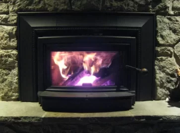

MikeSzak,
We did not purchase HI300. Just before final call to a dealer I have simulated the HI300 oversize surround. It was sticking out a few inches from the fireplace wall due to bulged stones. Our fireplace is build from rough fieldstones. Because of this issue, we thought to purchase a stove. We considered Jotul Oslo or Hearthstone Shelburne. But, our raised hearth has only 15" and a stove would have to be partially inserted into fireplace opening. We were concerned about stove efficiency and overheating blowers. So, I came up with an idea to go with insert that will fit inside of the fireplace opening. We looked back at the Clydesdale. We shorted fireplace opening on the top by mortar filler. Clydesdale surround height is just perfect now for our fireplace opening. On sides we are missing about 0.5" (+,-), but because of irregular stones the gaps are not so visible and we can fix it by adding mortar filler. Making long story short, we are happy owners of Clydesdale. We have installed the unit ourselves and started it on Halloween. This insert performs very well. The blowers are a little bit noisy when set at high but for the most of time I run them at medium setting. I am learning my stove's "personality" and wondering if Clydesdale is she or he. The Clydesdale is a workhorse for sure. Please look at the fire in the attached picture. Do you see a horse?
  • [Hearth.com] What would you put in our fireplace - Clydesdale or HI300?
I see your horse is a righty... mine, Clyde, is lefty. Looks great!!! i agree the blower is loud on high but i have to say, either i have become used to it or it gets quieter with age... (prob the former). anyway congrats and enjoy, i have had mine running straight since halloween as well. finally cleaned out the firebox last night. clyde burns everything to dust. i am amazed at how well it has performed.
