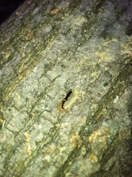

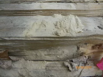

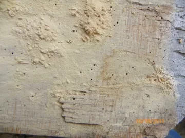

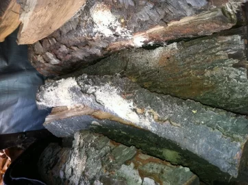

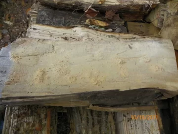

Stacked up a grapple load two years ago. Tarped it and left it to season. The other day I took the tarp off and found a bunch of sawdust. It seems to be present in a few places, not every piece. Any ideas what it is? Seems to like my ash. I'm 13 miles north of Boston. [Hearth.com] What's in the wood stack

Those close up shots don't look like ash. Ash borer will leave a D shaped hole in the bark.

Needs to see a body cause there are any number of critters that make dust like you are seeing. Don't worry, dey won't eat much whatever dey are!==c
Shoot straight is correct. Powder post beetles. We never worry about them except to make sure we whack off all that fine sawdust before taking the wood into the house.

Your house is probably safe if it is really in ash as mentioned above. Two beetles make flight holes like in the pictures. One is the Old House Borer which prefers softwoods. This rascal would love your house. :) However, this one was in a hardwood which would make it a Forest Longhorn Beetle. No problem here because he only attacks hardwoods, and won't infest seasoned woods like your furniture.
