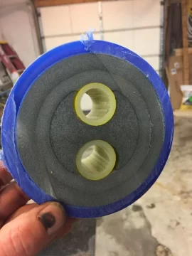

He is. I saw a cross section picture of it. And after I got the quote I went online and looked up parts and cost as much as I could find. I found out that the under ground PEX was the most expensive part besides the boiler. I'm not actually in Michigan, I'm paying this guy to do it at my moms house and I live down in louisiana. Other wise I'd do it myself. I'm renting the house out and I've found the gas bill is a little high for most renters. It's about $4,000 a year in heating, that's heating a 40 something year old house on a lake.

Yes, it does. The Watts site does say its closed cell. Do you know $/foot?
Insulation is a different color though. Long as it isn't a cheaper knock off...
