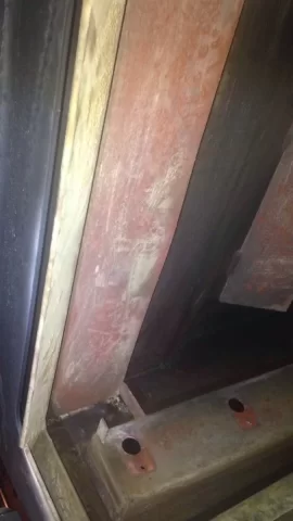

What's this steel baffle on my Englander 30?
Enplater
Feeling the Heat
Jun 6, 2017
266
NH
[Hearth.com] What's this steel baffle on my Englander 30? [Hearth.com] What's this steel baffle on my Englander 30? What is the purpose of this steel plate? As mentioned before it's and Englander 30. Maybe it's a heat shield to not superheat the front top of the stove or something, mine is also sagging a little.
That is where the air wash down the glass comes from.

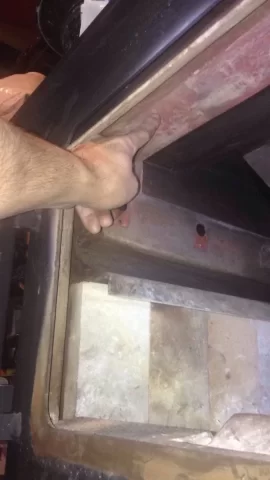

I thought the primary air came out of the steel that's angled down in front of the part I'm pointing at. I can stick my fingers between it and the stove top.
Yeah you are right. I didn't look close enough at the pic. That is a heat shield since the heat and flame roll up and over the front of the baffle right there.
That's what I thought, thanks for the info BB
I’ve melted both the front part of it that directs the air wash over the glass and also the part of it that your photo shows that runs towards the flue. The back part actually melted/buckled up towards the top of the stove.
Englander screwed up with too thin of material for that whole thing. Other stoves use much thicker material to prevent this. No big deal though, stove still puts out mucho heat! Burned mine today.
