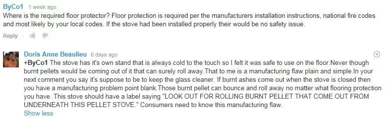

You got to see her comment on why there is no pad under the stove ! (Click the picture below to read)

She tracked it down pretty well in part 2. Good question why the stuff is getting by the airwash into the intake tubes. Looks like no vacuum and the vacuum switch should have shut the stove down.
Not if the switch has been bypassed !
She does like to hear herself talk!
Hearth pad? We don't need no stinkin' hearth pad!
And those boards the stove is sitting on are non-combustible, too, I bet!
"It's all about safety."
And of course, it's the manufacturer's fault! Somebody better tell them they make an unsafe stove!
This is the kind of person that blames your driving when they rear end you.
