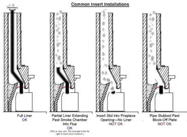

I have a daka 501 in my shop as primary heat , I have propane but refuse to fill the tank unless I'm pinched. In the house I just slammed in a arrow insert 1982 date. I have oil& electric radiant but also. Penny pinching or atleast trying. The cottonwood when it's dry is pretty wild. It's well seasoned and has been uncovered. It rained for a week, then snowed 5" then melted and rained another week and just froze up on Monday. So it's all soaked. I'm trying to keep a pallet or 2 in the shop warm to dry. Kind of.
Slammer install into a fireplace, no direct-connect or positive connection? If so, you're "playing with fire" so to speak. :oops: Really need to at least direct-connect (pipe up into the clay liner tiles, and a block-off plate,) if a full-length liner (positive connection) isn't in the cards right now...

Slammer installs are no longer legal. Keep close track on creosote buildup in the chimney. Damp wood + big cool chimney can = rapid creosote buildup.

I have it direct connect I guess. 3' of 8" going into the clay tile. I don't have a block off plate manufactured I didn't realize I needed one. That will be on the list for the coming week. I have it all packed in with insulation now, ideally one day I plan to get a newer insert and do the proper liner. But 650 ducks just for the liner heats my house 1 season With zero work. I do my best to burn hot with not much smoke to avoid disaster. My shop stove the last 2 mornings was gray on the inside , I thought the first time I over fired it. And I think I did. But this time I watched it and kept it choked down. Seems to turn back to brown or black by the end of the day , after being cold all day.

OK, sounds like you have a handle on what to watch out for. Here are some block-off plate threads, which I found by using the search in the drop-down "forums" menu at the top of the page . Some guys have used Roxul mineral insulation as a stop-gap measure until they can get an actual block-off plate installed. It won't keep the heat in the house as well as a block-off plate, but it's more heat-resistant than the pink stuff which will kind of bake and pull away from the pipe. https://www.hearth.com/talk/search/19630047/?q=block+off+plate&t=post&o=date&c[title_only]=1&c[node]=6
That's what I have, I have the entire cavity stuffed full of Roxul around the pipe to seal it and all around the insert. I have some metal around I might get that done even this weekend. Do you think I could put a 8-6 reducer on the stove without affecting performance? I can run round pipe and a couple 45's and re line the chimney. Without cutting the back plate in the fireplace
I can't speak for your exact situation but I have an 8-6 (reduction is near ceiling) reduction on my stove and it has a great draft. I have never had an issue on draft at all. This new stove drafts better than the old one.
What size is your clay liner? Does the stove have decent draft now? If the clay liner is pretty large, and it's still drafting OK now, it's possible you could get away with reducing to 6" to get through the damper, especially if this is a pre-EPA stove and you have 20' of stack.

It's large. 12" I think. Or whatever the larger size is. If I had half a brain id take a tape to it. It drafts awesome. Open the door cold it's sucking air. Never have any smoke spillage even on the wicked wind days. (Every day in the flats). Yeah it's an old bird. And I have lots of chimney. It's seriously thick brick around it too. Bout 3'x5 all the way up so masonry insulated if you want to call it that
