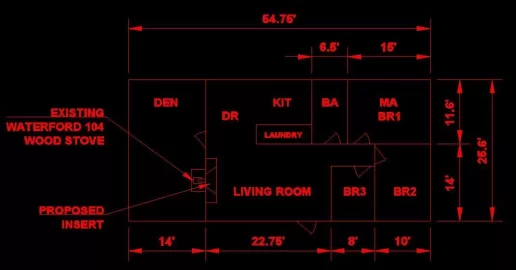

Alright, so here's the deal...
I have a little Waterford 104 that can heat the den. On the other side of the wall is a field stone fireplace that I am looking to put an insert into. With a bigger stove, more centralized heat, how obsessed I am with getting free wood, and the fact that the house is all electric heat... I am 100% sure I will be upgrading. The two problems are when to buy and what to buy.
My options:
When to buy --- Buy an insert now. Buy an insert in the middle of the summer (what kind of discounts can I get in the off season?).
In April I will be receiving the $8,000 first time home buyer tax rebate with my tax return. Would be nice to spend free money to get the insert, and then get 30% of my free money back again. I can make it through this winter. I have no problem getting my wife a few sweatshirts... So I guess I answered my own first question.
Buy later - where can I get the best discounts?
What to buy --- There's a thousand different stoves that fit my requirements. I own a 1,360 sq.ft. Ranch. I would like something that is set for 1,600-2,000 sq.ft., looks good (the only thing that's important to the wife), does the job, and is on the cheaper side (obviously)...
The dimensions on my fireplace:
Depth: 24"
Rear Width: 24"
Front Width: 30"
Height: 28"
I would like to follow up with, cheapest place to get the 6" stainless liner kit. Anyone got a really good price?
