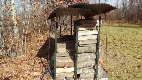

When you use the metal sheets how do you keep them from blowing always? Cinder blocks on top or just wood? Metal sounds like it will work better than a tarp. It will sail away in the wind easier.
I've not yet had to put any blocks on the metal but just some of the bigger uglies. For sure metal works much better than a tarp and for sure you have to take measures to hold them down. If it takes a couple cement blocks, that should not be a big problem. I have had a few blow off but very few. Whenever I pass one of the wood piles I just automatically look at them. I like the sight and it also tells me if anything has shifted. Had one shift one time that I didn't catch and that caused a lot of water to get down into the wood. That part of the stack really showed the ends of the wood as almost black in color.
I top cover as soon as it's stacked. Certainly can't hurt! Think about it, why let extra moisture onto your wood, after all the goal here is to get it dry!
I've got 2/3 of a cord under some tin that I found at our local Recycling Center (dump). I used some old bungee cords, also from the dump, and hooked them to the pallets.
