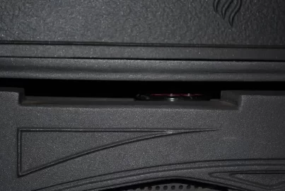

This is where I put mine. You will need a flashlight to read it, but it works for me. Also, to get an accurate reading, read it before you turn blower on.

stejus, based where you have your thermostat, what temp reading do you shoot for?
550 on mine is cruising temp, but I think I'm low.

550 - 600 is where I put the blower on. Cold nights I let it climb to 600 before turning on blower.
