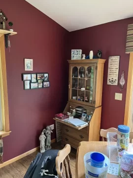

Our upstairs is very open and there is really only one place to install a wood stove, its the corner in the photo below. I dont need a large firebox because it will get way too hot, but I dont want one that's too small the needs loading often either. I looking for ideas on something that could be possibly be turned down without a high heat output with a mid size firebox. I have the 13ncl to compare with, that box seems a little small but I could live with it since it would be more closely monitored than the one in our kennel is now. Perhaps a hybrid or cat stove to keep the output somewhat lower? A stove that qualifies for the tax credit would be nice also. With a corner install clearances have to be taken into consideration. In the photo below, the corner to one window is 55" and from the corner to the other window is about 52". So maybe a stove with side shields? I've been reading a lot of posts on different brand stoves and its easy to get lost in the confusion. I would also need to heat shielding for the floor and walls, plus a chimney install. There's no need to be in a huge hurry, but I'd like to get a ball rolling for possibly something this season. I'm pretty busy at work so time is limited but if I find a stove and purchase it, than I'm committed. I've been looking at Drolet, Englander, Woodstock, BK, and others. And and all ideas welcome, many thanks.

The main issue I see with that location is that the chimney will need to be tall outside. Heat shielding for the walls is not needed as long as the stove's clearance requirements are honored. Many modern stoves only need ember protection for the hearth.

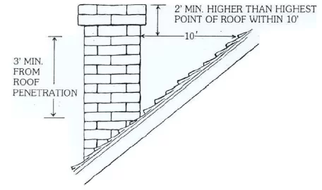

My home is 1280, upstairs plus 1280 downstairs (32x40). The LP furnace is 60k Btu's input and 56K Btu's output. The living room ceiling is vaulted in the center so the corner height is 8'. I have a 12/6 pitch roof so the chimney would be kind of tall but being in the corner its the shortest distance outside. I believe the. outside chimney needs to be 3' higher than a ten foot radius. Im guessing my wood furnace chimney is pushing 25' since its in the center of the home and sticks out 3 feet higher than the top of the highest point on the roof.
That would be 2 ft higher in a 10 ft radius. Many stoves need 15' minimum chimney height for decent draft so check stove specs when planning. The exceptions are some Canadian stoves from Regency, SBI (Drolet, Osburn), & Pacific Energy, which can work with shorter 12-13' flue systems. Note that the chimney will need a roof brace at 5' above the roof exit. In heavy snow areas it is advisable to put a snow diverter (cricket) above the chimney.
