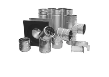

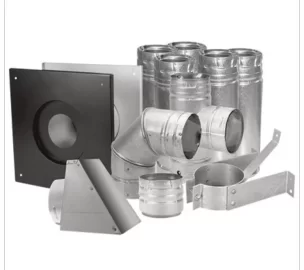

While looking for an AC 3000 vent kit for my stove I ran across two different versions. Not exactly sure which one to get.
Lowes has a version that has a screened off exhaust cap while other versions I found have a hooded exhaust cap. Lowes is a little cheaper but not sure about of it’s ability to keep out rain etc.
One thing I do see now is that the Lowes version looks like it will set the vertical pipe closer to the wall. The bracket looks like it doesn’t stick out as far unless I’m looking at it wrong.
Does that mean the stove will set further from the wall on the inside?
I'm pretty sure the difference is that the kit with the hood is the original pellet only kit the other kit is the pro version which is multifuel rated and rated for closer tolerance to the wall hence the shorter wall bracket.

I use a 45* angle pipe out my exhaust cap for the main floor stove. I angle it slightly away from prevailing winds and don't have an issue with moisture. So I don't see why the screened cap wouldn't work well. However, I don't have a vertical run outside either, so that may make a difference depending on your set up.
Well I bought the “new” non hooded version kit from Lowes today. It was $199 but with a Veterans discount came out to $179... plus tax of course.
