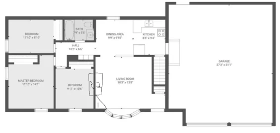

Hi! I'm new to the fireplace world. Just bought a house and we want to add a fieldstone fireplace. The house is 1000 square feet. We want to use the fireplace to heat the house, primarily. Stopped at a fireplace store and they had two inserts, Pioneer and Napoleon. I didn't find any reviews for Pioneer, but Napoleon got some bad reviews, mostly for a loud blower and the glass is hard to clean.
Need a little help, please. Which insert is the best in the market for our situation?
I want to add, we have three places where it can go in this ranch house. In the corner (#1), in the middle of the wall (#2), or we could do a double-sided (#3) so we could have it in our bedroom too. Is a double-side a bad idea? I heard it's too drafty.

For heating the house and due to code, #3 is out, 1 or 2 will work, though you will have to measure and make sure there is enough room in space #1. I think you mean a Zero Clearance fireplace instead of an insert. An insert is inserted into an existing masonry structure. For a small home, you might also consider installing a freestanding stove on a nice looking hearth. That would not only save a lot of money, but some stoves qualify for the 25% tax credit, and that includes the full installation costs. You might also look at some 2 cu ft models from Astria, RSF, & Pacific Energy.
Ranch layouts are hard to heat at the far end of the hallway without assistance, so the fireplace or stove will primarily be heating the living, dining rooms, and kitchen.
I love those double sided fireplaces because I see them in restaurants and I think they are near looking..Why would number three choice be out---just curious--gosh the person could have heat in the bedroom and living--why not begreen? clancey

You can't have a solid fuel burner in a bedroom. And regardless the few double sided fireplaces available are not heaters anyway. They are just for recreational fires.

Thanks so much for the help. Good to know now that we can't do the double-side. As for the free-standing stove, I have wanted a fieldstone fireplace for years. Finally have the chance to get one, so I'm going for it. We could try using fans to direct the heat down the hallway. And possibly if we put the fireplace in the corner, the heat will go further versus putting it on the straight wall where it faces one end of the house. The house has fuel oil, unfortunately natural gas doesn't run out there, but at least we'll have a back-up.

The Clydesdale is not a zero-clearance fireplace, it is an insert designed to go into an existing fireplace. It would need a full, masonry fireplace built to install it in, $$$. Also, I am not sure if the 2020 version is at dealers yet.
The corner location is not going to help get warm air into the hallway and far bedrooms but a ceiling fan will help. In ZC fireplaces, one option would be to get one that can duct heat into adjacent spaces. Is there a basement or attic when an insulated duct could run through?

Oh, okay. We can definitely put in a ceiling fan. There is a basement and an attic, so we could run the duct work in either of those.
