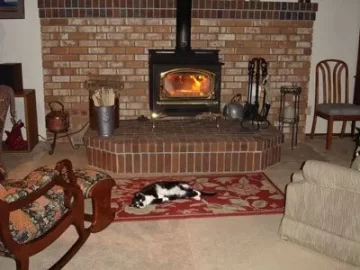

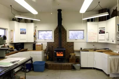

Any suggestions as to how high the hearth pad should be?

I burn in two stoves...one in the house, and another out in my workshop across the driveway. In both cases, I had masonry hearths built that lifted the stoves 12" above floor height. I love them that way. I think they look good, and I don't have to do so much bending over to tend the stoves. Couple of old pics attached (shop cabinets have since been finished and the house remodeled...but the hearths remain just as shown). Rick

Nice stoves and hearth's Rick! I would think the bypass would be a good thing on reloads especially if you are adding to a burning fire..
