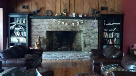

I live in Eastern Tn, and have a Fireplace that the opening is 4'X6', not sure what to put in it. It has an ash dump and the flue is 8"X4'. I want some thing that gives me the most amount of heat. Moreover, I live on 50 acres, so I have plenty of wood! The ceiling in the room are tall and it opens up to 2 bedrooms upper lever.

That is a nice start. It's a beautiful fireplace. I agree with fossil. It looks like it could hold a big stove.
To make recommendations we need to know the fireplace dimensions and a bit more about the house. Is the floorplan open? Is the fireplace room open to the rest of the house or closed off? How many sq ft total will be heated?

The photo of the fireplace and the dimensions are in the original post. The floor plan to the house is open. It is a beautiful fireplace, and I hate to cover it,but it is not functional.

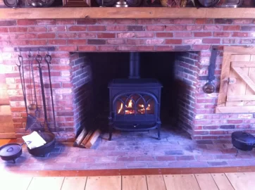

Personally I can see a big jotul in there. But just like begreen said tell us more about your house, what you want to accomplish as far as heating I would imagine that you would like to heat with would exclusively. What are your preferences? Insert or freestanding?

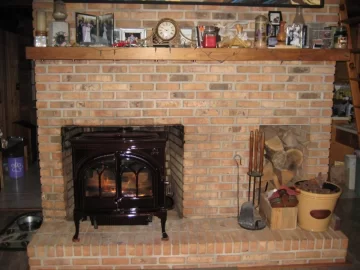

[Hearth.com] Which should I do? I put my Jotul F600 in front of my fireplace opening, but my opening wasn't as large as yours. Here is a picture of what it looks like sitting out front.

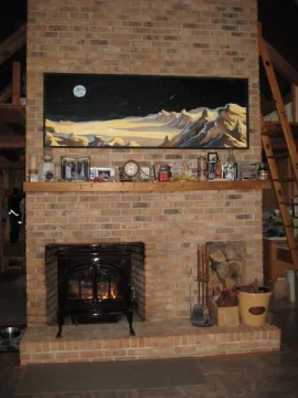

Something like this? We did this one last year.
