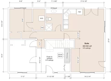

Hi,
I could use some recommendation on wood stove size. I'm on Vancouver Island, and trying to squeeze in before the 2020 regulations. I have a choice between a Napoleon S4 and S9, but I'm not sure which to choose. The stove will sit in a 12'x12' foyer with a short staircase going up to 1200sqft. The lower floor will potentially be opened to a full 2300 sqft size when the two units are joined back together. House has some batt insulation in the exterior walls and attic, and is slab on grade construction.
I'll be burning 95+% Douglas Fir, in a supposedly temperate climate. It doesn't get much colder than 15F or -10C, and usually hovers at the freezing mark. I don't want an oversized stove for the house, but the foyer is a perfect sacrificial space which could be too hot for comfort, but all the heat rising to an open upstairs.
Will an 85000 BTU stove be too big? Should I go with a 70000 BTU stove instead? To what extent will the heat be conducted through interior walls and absorbed by the chimney stack? How honest are the manufacturer specs, or are they overstated?
Thanks in advance for the help.

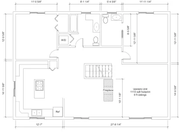

Take the maximum btu output ratings of the stove with a grain of salt. They are mostly for marketing purposes. You have to push the stove hard to achieve that output on a constant basis. Looking at the floor plans I wonder if the "chimney" is large enough to accommodate two liners? Most stoves are area heaters. From a heating standpoint, the stove at the first floor location is going to do almost nothing for heating the first floor. Might as well have an insert upstairs and tap in a second liner on the Suite side on the first floor. That is of course if the chimney has two separate liners. Under that plan it looks like both the insert and first floor stove could be around 2 cu ft.

Thanks for the input. Unfortunately the upstairs fireplace is double-sided, and will not be altered. Although it would be possible to tap into the flue from the suite side, I don't want a stove in there.
Would a 3 cu ft stove be functional if not run at maximum loads? I feel like there are lots of generalizations on these spec sheets when in reality local climate, exclusively softwood that doesn't dry well in damp winter, and house design can affect numbers.
