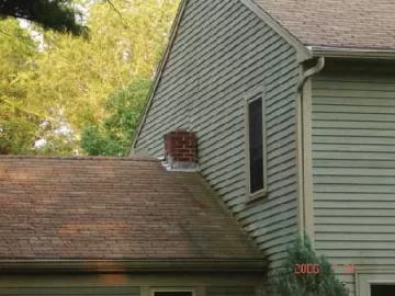

No modern stove is going to work well on an 8ft chimney.
Yeah no stove is gonna work worth squat with less than the 15-16 foot chimney they are designed for. This one didn't.
