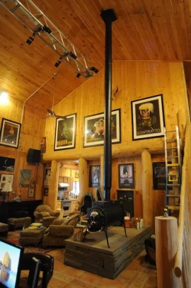

Anyhow, i recently moved in to a very large house in central NC with an open floor plan and a 3 story living room ceiling with an open fireplace a massive 4 by 10 ft chimney. In October, I installed a Fisher grandpa bear to see if it was possible to heat this space. It is possible, even on a 20 degree night. The Fisher has no internal baffle, however and I estimate I'll go through over 10 cords to heat the house for a winter. I want to decrease wood consumption as much as i can by getting a better stove.
