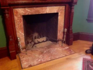

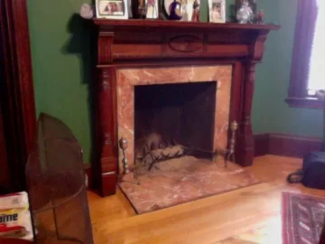

I've been checking inserts now that I have a layout of your firebox on the computer. Most inserts will either be small or will need to have a very prominent front, which will probably require a hearth extension.
Can you post a picture of the fireplace? It sounds like it is tailor made for a nice hearth stove. I'm thinking a Woodstock Keystone or Hearthstone Shelburne for starters.
Here are two pics. Let me know if you need any more/different angle, etc.
I have my heart set on an insert for a few reasons (feel free to tell me your thoughts):
1) I like that it gives the feel of more of a "real" fireplace
2) The room it's in isn't huge, so I will loose more of the room with a freestanding stove, even versus an insert that sticks out a bit and just having to extend the hearth a bit.
3) I have small children and it strikes me as a little less of a danger being pushed into the fireplace (either way I'll probably have to get a gate for the next few years).
4) I've heard the inserts are better at heating larger portions of the house, vs. the freestanding which is better at heating the room it's in - don't know if this is true.
Again, the room it's in has a ceiling fan, and the floor plan is pretty open (not completely) including a pretty open area up to the second floor.
Thanks!
Kenny

Thanks Kenny, that is a big help. The photo points out another serious issue, clearance to combustibles. I'm assuming you don't want to touch the nice woodwork, so this will affect the decisions. The good news is that it looks like a nice generous hearth. I am thinking about a stove half in the fireplace so that you can maintain 16" from the stove glass to the front edge of the hearth.
As for the concerns, they are reasonable, but not all based on the correct assumptions. Personally I think an insert will look wrong there unless carefully styled. This fireplace has a period look. It will require a custom surround because of it's tall aspect. Filling that area with a modern rectangular box is going to work against the visual lines, in my personal opinion. A classic look of a Castine, Shelburne or Woodstock stove is going to be much more in character. The issue with children is the same regardless. They need to learn that the stove is hot and will cause a bad owee. Fortunately, they usually learn this very quickly. If still concerned put a child safety gate in front. I'm not sure where the last conjecture came from, but in general you will get better heating from the freestanding stove.
I agree w/ BG. A free standing stove will look better in that very nice fireplace. This is coming from an insert guy. Free stander does not require fans to get the heat into the room either. My fans are quiet but not as quiet as no fans.

As you can see in my pics, I have a marble hearth that extends 18-1/2" and then a wood floor. Would I need to put something down in front of the marble? Part of my concern is cutting into the space of the room with the fireplace (which is not that large). I'll only be able to get the stove so far into the fireplace - while my opening is 30" in the front it quickly tapers off to 19-1/2" at the back (again, only 15 inches deep). If I do go the the direction of the freestanding stove, I saw a very good deal on a Hearthstone Heritage in my area, but it looks like that might be too big (I don't think I could even get the back legs into the fireplace).

The Hearthstone Heritage is a side-loading stove that would need to sit our further. The Tribute is a front loader and might work better.
Can you provide the following dimensions?
What is the distance between the hearth and the bottom of the mantle where it projects more than 1"?
What is the the distance from the center of the fireplace to the nearest side wood work?
BeGreen said:
Can you provide the following dimensions.
For the first questions, do you mean from the ground (on top of the marble hearth) to the bottom of the mantle where it projects more than 1"? If so, that's approx. 35"
The distance from the center of the fireplace to the nearest side woodwork is 21"

This is going to be challenging. The issue I keep running into is clearance to combustibles, namely the side trim and mantel.

Let me take a look. It may turn out to be one of the best options. It would just squeak in if all dimensions are accurate. There may need to be some mantel shielding, the dimensions are close there too.
Download this document and you will see how close things are. It's a squeaker, but may be possible with a good installer. But the mantle still looks like an issue.
(broken link removed to http://www.hearthstonestoves.com/assets/files/document_library/schematic-morgan-select.pdf)
