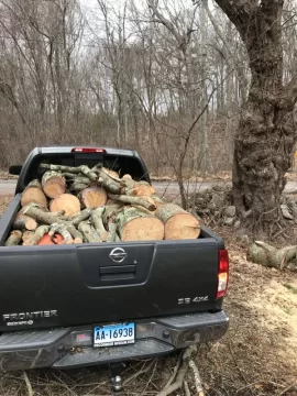

[Hearth.com] White Pine Tree Man, I hope there is nothing wrong with burning pine, just picked up a truckload today. All kidding aside, I have burnt whole trees worth of the stuff and no problem with chimney. Great kindling as well. As Flavor Flav says, “don’t believe the hype”.
