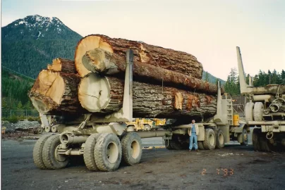

Yellow pine has a btu value very similar to Douglas fir .30 years ago when I was running log loader would set the yellow pine aside for firewood ! White pine is more common but half the btu value.

This picture is 40 years old and is firewood ,snag and windfall logs were considered to be pulp so in the small community where we lived it was firewood for the employ's !
Yellow pine has a btu value very similar to Douglas fir .30 years ago when I was running log loader would set the yellow pine aside for firewood ! White pine is more common but half the btu value.View attachment 338607This picture is 40 years old and is firewood ,snag and windfall logs were considered to be pulp so in the small community where we lived it was firewood for the employ's !
That truck load of firewood is likely much better wood than we can get nowadays in the box stores for lumber.

^^^^ That is the tree guy who shows up after his ad says,
"Truck load, all hardwood. Might have to 'buck it to fit your stove"
@hobbyheater
Can't imagine the volume of Ibuprofen required to work up those two truckloads ;lol
Guessing you might be looking for another load finally. After 40 years! Oofda. Dats alot a firewood.
