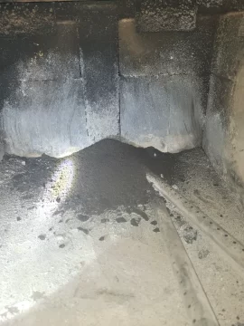

This is what I got after cleaning chimney,this is after burning 5 cords jack pine

IMO, you all are correct in that the wood must be properly seasoned. In clean burners, we’ve burned pine with no problems. The smoke dragons we’ve had always had a lot of 1 & 2 stage creosote and I am sure the pine did not help.
It is likely people purchase “seasoned” fire wood as they need it and that wood, here in VA really is not ready to burn until next season after you have covered it. The wood might be ready to burn in a fire pit or an outdoor boiler but it is probably too high in moisture for most wood stoves and fireplaces with any typical length chimney.
