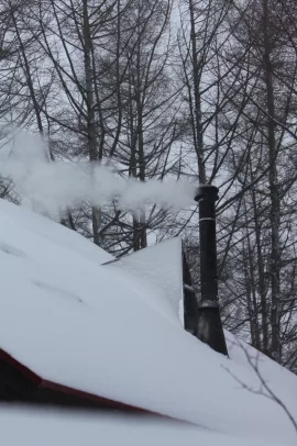

Update: I arrived at the building yesterday, and I've attached a picture and video of the ouside when I'm reloading, and the cat is not engaged. While the comments might be 100% accurate (spark arrestor), this video to a person like me suggests there is little to no blockage. I also took a picture of the stove pipe from the bypass last night, and it was clean as a whistle. Now, in regards to the cap, I don't have a factory spark arrestor, but I have a bird arrestor home made cage, that probably has the same impact. The installer arrives tomorrow, let's see what he says. I like the comment about the leaking flue potentially sucking in cool air.
For anyone who says I should get rid of the cap, how am I supposed to deal with snow coming down into it when I am not around (only visit once per week). I get a lot of snow over the season, and the cap either will be on, or off permanently as I have no reasonable access to it at anytime of the year.

Final report: Stovepipe was clean, except at the very top where the homemade spark arrestor/bird screen was. Once the build-up was removed all issues with smoke coming into the room during reloading were resolved, and the box comes up to temp easier on initial start-up as well.

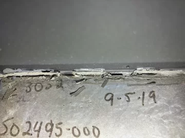

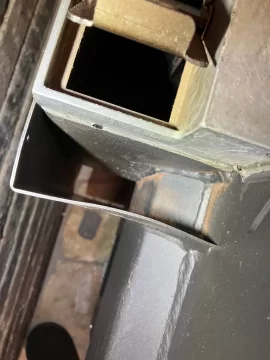

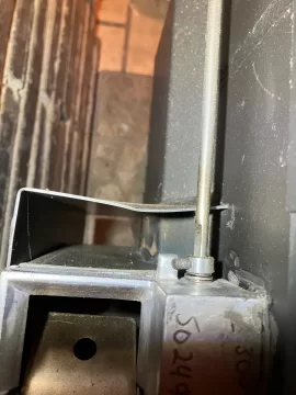

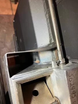

2025/2026 season update: Extended my outside stack by 1.6ft, and removed the hand-built bird cage near the cap., This was a good thing to do as my setup is now more stable, I get less smoke coming into the room on reloads, and obtain more draft (I'm hovering around the recommended total stack height, and have no bends along the way). This also brings me closer to being compliant with the 3-2-10 rule. It wasn't cheap to do all this, but as it's a noticeable improvement I'm happy with the results.
As I cannot keep from fiddling with this thing my project this year was to try and get longer burns without stalling during the shoulder season. I cannot do this in the winter as my log building is drafty and I need all the heat I can get (I reload every 12 hours during peak cold days, dial set to around 4:30pm). I've been monitoring other threads here about people with long burns, and there is no way I can go above 15 hours without stalling the cat. Therefore I decided to take a look at what my flap was doing (yes, I read all the BKVP warnings):
Cold stove:
Flap FULLY closed (touching the frame, only air going through the emergency round hole): 2pm on the dial.

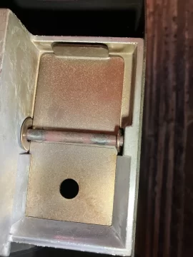

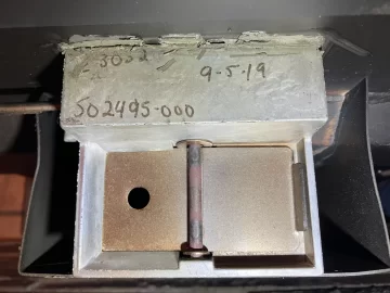

Flap FULLY open (about a 45 degree angle, photo "179" shows this): 5pm on the dial. Turning past 5pm the flap does not open any further.
Hot stove:
Flap FULLY closed (touching the frame, only air going through the emergency round hole): 330pm on the dial.
Fap FULLY open (about a 45 degree angle, photo "179" shows this): 6pm on the dial (however, it might go higher if could move the dial past 6pm to about 630, but this is close enough, and I don't plan on messing with the set screw).
So, in my situation, when the stove is hot/operating, if I go below 3:30 on the dial, in a few hours the cat will stall. Therefore I can only get around 15 hours out of it with the dial just open to about 3:45/4pm (flap open just a hair).
Does this sound right?
There seems to be some damage to both sides of the frame the removable flap cover sits on, can I assume this has NO BEARING on safety or performance? I've added some photos to better describe this. The "flap box" welds also seems to be having some gaps where they connect to the main body of the stove. Also no problem/concern at all?
I wouldn't say that. If it's hot and you're dialing down, the flap will close, yes, but that doesn't mean it's going to stay this way. Once the stove has cooled to adjust to your lower heat demand, the flap will open again to keep it at temperature (without a cat stall).
I can run mine at around 2:50 without the cat stalling, but that's about it. At 3:00 it certainly won't stall.
^^ That.
The flap moves when you don't touch it, during the burn. That's the whole point of the bimetal thermostat controlling the air. Dial down to 3.30 it may close b/c the stove is hot. But dialing up to 3.30 it will likely be open (to some degree).
Also, "less smoke in the house" to me suggests your draft is still marginal. That is consistent with it possibly stalling at a higher thermostat setting than in many other installs.
How tall is your flue now?

The manual recommends a double wall stove pipe and insulated chimney, so that is the premise for its height recommendation.
Your chance observation seems fine. You just dialed it down to a lower setting than its actual temperature at the time, leading to the dial opening. It'll close later when it has warmed up more
Regarding the second observation, this is a bit puzzling, but the thermostat does not control based on the cat temp. I.e. a cat stall may not directly correlate to the heat generated at the lowest setting. But it is a bit odd imo indeed.
Note that you don't need to back off a mm for it to breath; that's what the hole is for in the flapper.
If it doesn't breath enough using only the hole, I still think your draft is a bit below the minimum. (Flue height could use a foot or two more.)
Sure sounds like wet wood or poor loading just not wanting to keep burning. I'm also a little curious about how with a cold stove and fully hot dial setting the flapper is not fully opened. Is that normal for other owners? On my princess she goes way open, that flapper runs up to a hard stop against the screw in the cover.
Not really, I think. I also have to open up the thermostat a little towards the end of the burn to keep it from stalling. I really can't measure the heat output reliably, but I think you're right: the thermostat controls the heat output, so far, so good. But near the end of the burn what's left is mostly charcoal and no more volatile gases in the wood, so at the same heat output the cat gets less food, requiring the thermostat to be open a bit more to not stall. That would make sense to me.
Of course the whole thermostat control only works if the draft is high enough that opening the air inlet actually results in a higher stove temperature.
