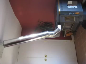

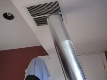

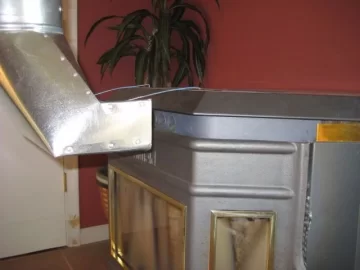

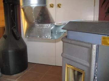

Hi Guys,
I wanted your comments on my new setup with my Whitfield. I installed this stove in my basement (finished) right below the HVAC ducts.
I cut a 12 by 12 opening for a return grille so that the heat from the stove would get sucked in and circulate throughout the house.
Well, that was not good enough for me. I just got some ducting to implement the setup pictured in attached photos. So far, so good.
Has anyone done this type of thing before?

Not pretty... but if it works. I would stick a smoke detector in that ceiling grate. Those pipes can rust out.
Hmmmm....hadn't thought about the pipes rusting out! I agree it's not pretty, but it's in the back of the basement. I'm seeing about 150 degree air going into the grill.
140 deg on setting #1, 160deg on setting #2.....not very much difference.
