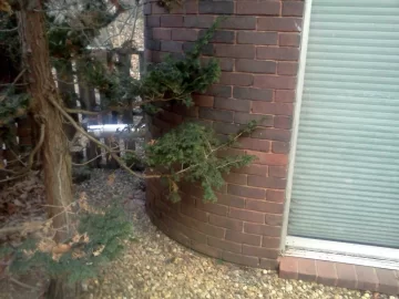

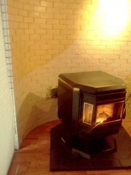

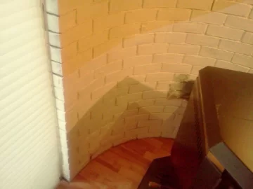

I smell a faint odor - thinking it's smoke - pics below show it's installed about 36" from a (drafty) glass window. Now, that measurement is on the INSIDE. On the OUTSIDE (because of the curve and the thickness of the wall, it measures about 48" (pics below). Because I'm paranoid and love my kids, I turned the stove off, will go hunt around for the Carbon Monoxide detector to install, and he will fix the drafty window when he gets home today (and of course HE loves his kids too, and is doing this so they can be warm).

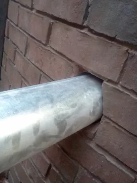

Do we need silicone/something around the outside?

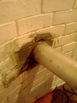

I don't know that he used a thimble, I don't see one, but I think he read he didn't need one going thru brick?
What do you think of this installation? Did he do OK?

I'd definitely seal around the outside. And, yes a CO detector/smoke detector combo would be smart.
