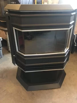

The heat exchanger tube scraper rod seperated from the scraper. There is no threads on the rod that I can see. It appears to be a welded or brazed method of attachment. How do I get to the scraper easily to make it a comlete usable scraper and rod assembly? Thanks for any assistance. Earl C. Tourgee
Hello
I replace the scraper rod on my Whitfield Advantage Plus with the Scraper Rod Replacement Kit.
This should work on your stove too. :)
See pics and detail here
https://www.hearth.com/talk/threads...g-upgrading-an-old-broken-scraper-rod.169181/
