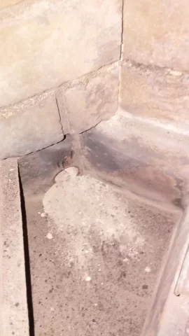

Both corners have little door that slide open and ash drops in pan.Do the side panels come off i didn't see any screws at all unless its those little slide doors there the ones that were seized open have 3 of them one in middle and one on each side
Found it

Getting there went to put the hole plugs back in and my finger went right through the cap.Man they sell a hole plug kit 114.00 and there is only 2 in the stove so i don't know if they give you more in kit.I would hope tjere more then 2 in the kit there only 1-1/8 round
Where did you see that price .... seems really high.
That area is behind the fire brick right? Should be OK as I've seen them used on the Magnum Baby Countryside stove....
There it but its not behind the fire brick there down below the burn pot in the corners.Yhanks for your help happy thanksgiving to you and you family
