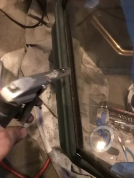

Pic 0 - Optima 3 green with gold trim.
Pic 1 - Air Wash on bottom inside of fire door
Pic 2 - Removing 5 hex head screws after wire wheeling them clean and spraying with PB blaster
Top air wash is removed the same way.
Pic 3 - Removing air wash guide
Pic 4 - Yellow Arrows show air wash slot above air wash bracket screw hole and below glass bracket screw
Pic 5 - Utility knife in air wash shows how small this slot is
Pic 6 - Pellets stuck on outside of fire door that may block some air from getting in but it may pull from the bottom
Pic 7 & 8 - Knife in air wash slot shows tip of knife on the outside of door.
Pic 9 - Air Wash guide and ratchet for removal

Hello
After blasting the air wash bracket clean and painting it inside and out. The door inside the air wash bracket was also cleaned and painted so the air will flow better.
Cleaning was done with a razor blade, wire wheel and acetone from Home Depot.
Paint is VHT very high temperature 2,000 Deg F car header spray paint from the auto parts store.
Pic 1 - blasting the air wash bracket clean with white aluminum oxide.
Pic 2 - Painting the air wash bracket inside & out
Pic 3 - cleaning & painting the fire door inside the air wash
Pic 4 & 5 - Bottom air wash all done.
Pic 6 - now for the top air wash bracket!
