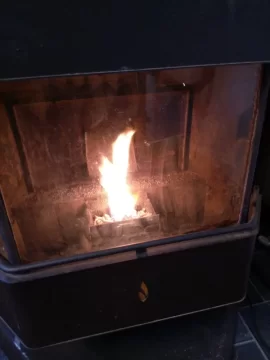

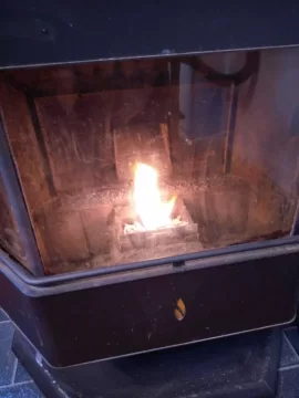

[Hearth.com] Whitfield Pellet Stove cutting off [Hearth.com] Whitfield Pellet Stove cutting off [Hearth.com] Whitfield Pellet Stove cutting off this is the flame at start up. But it doesn't stay continuous. It will die down and then light back up and then eventually stop feeding pellets
Did you jump the photo sensor? 2 yellow wires
Ok im gonna have to get my test bench out and try my board and see if i can duplicate your issue.
You have a door switch that could be acting up,and a pressure switch that could be acting up.You can jumper them,and see if it stays running.
The pressure switch will stop your auger from feeding. That and the over heat switch are connected to the auger. No fuel, no fire. Have you cleaned out by the exhaust fan by removing it. Mine was absolutely stuffed with soot.
