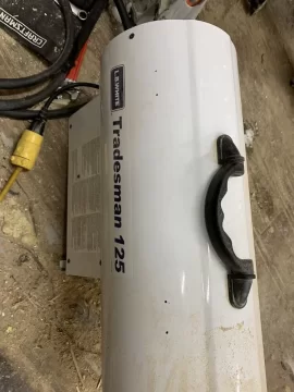

I was able to get the pilot light to stay lit!!!... I blew out the lines and re-tightened everything...and then I put a torch to the T-Pile and it worked.... now to the next issue...when I turn the stove on... the burner only partially lights up...its like there is not enough propane being pushed into the burner.... any ideas? I am using a propane tank with a regulator... same line I use for my propable heater, which works fine... are there different regulators? I am a cabinet maker and work with wood...do not know much about stoves etc!!! so thanks for your help!!!
Does your Whitfield unit work better when the other heater isn't running?
How long is the gas line what diameter is it?
