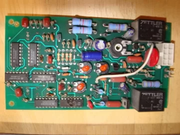

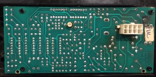

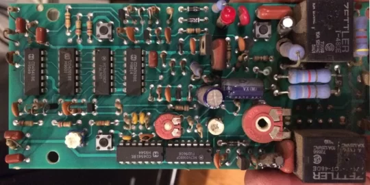

My main concern is sacrificing the control board for a motor and then getting into a (see Bugs) situation.
The control board in your regular Quest is very different from those in Bugs' Advantage and my Quest Plus. For electronics geeks a lot of interesting details could be analyzed here, but that would fill the thread. I promise to stick to the thread subject:)
I searched the internet and found some relevant pics of regular Quest control boards:
[Hearth.com] Whitfield Quest WP4 convection blower [Hearth.com] Whitfield Quest WP4 convection blower [Hearth.com] Whitfield Quest WP4 convection blower
As we can see, at least two slightly different versions were made through the production years ( 1994-2000 ), but the speed control of the convection blower is the same on all versions: A 10 amp Zettler relay toggles between the two stator windings, when you press the speed hi/lo button.
Increasing the amp-draw from 0.90 A to 1.5 A should be in a safe distance from the max. rating of 10 A of the Zettler relay, but as Bob states, the increased airflow could cool the stove too much. You'll have to try it out. Good luck. Keep us posted.
The datasheet for the relevant Zettler relay is attached below, so you can study all the specs.
Edit: I just noticed that the Zettler relay on the board is a heavy duty type ( AZ-941-1CT-48DE ). This is good news in that the relay max. contact rating is 16 A and not 10 A.
